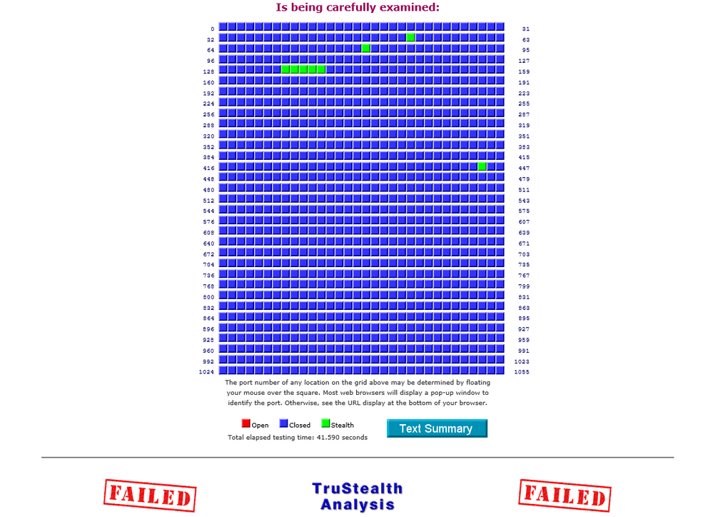

Ok I found my test results from January with a modem only:
CM1100>RBR850><Wired Windows 10x64 PC connected to RBR only. No other devices connected.
Browser: IE11x32
Site is reporting stealth mode for a few ports:
GRC Port Authority Report created on UTC: 2020-01-20 at 23:34:26
Results from scan of ports: 0-1055 0
Ports Open 1048
Ports Closed 8
Ports Stealth --------------------- 1056
Ports Tested NO PORTS were found to be OPEN.
Ports found to be STEALTH were: 53, 80, 135, 136, 137, 138, 139, 445
Other than what is listed above, all ports are CLOSED.
TruStealth: FAILED - NOT all tested ports were STEALTH, - NO unsolicited packets were received, - NO Ping reply (ICMP Echo) was received.
I presume this probably hasn't chanced since I tested this on v3.2.9.x.
I'll check this again with most current version of FW.

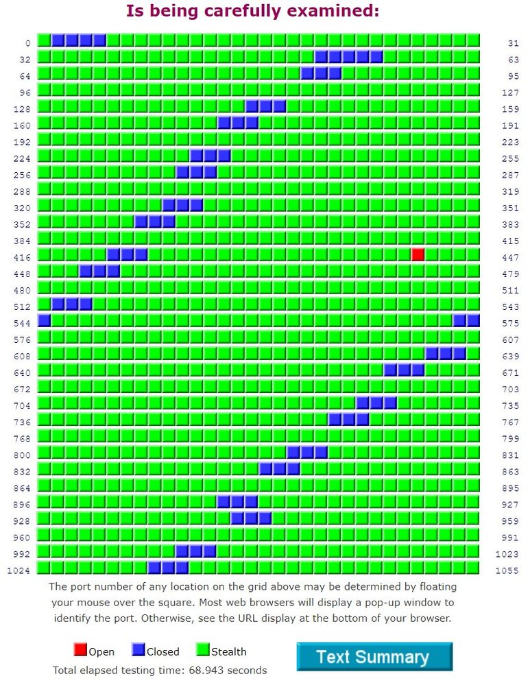

May 17, 2020Apprentice
My firmware version says it is the latest (I guess official/public) release.
V3.2.10.11_1.2.12
Putting the faux DMZ up is to protect my network; it does nothing except make more 'blue' (exposed) ports to 'green' (stealthed) with the goal being to stealth all ports as it just sends the incoming traffic off a cliff.
I already had the other settings in place per the information I provided (re: wan ping and ddos), other than I can't just unplug and disrupt my network as requested, so there are many wired and wireless devices connected to the router. Why would this matter?
The only UPNP requests are from the PCs setting up network / home sharing on the LAN side. There's no business or justification for having ports open for that or anything else on the WAN side as well given the port forwarding and related configuration.
With this setup, the port scan gives the same sort of pattern as the OP already posted in their screenshot (although I tend to only get 3 blues instead of 4 in a row, per row).
The router also doesn't even realize a port scan is taking place. The logging option to report "known" DDoS and port scans is checked, and yet it captures nothing.

- tantrumMay 18, 2020Apprentice
This (if it posts this time) is approximately what you are trying to beat, but with no blue squares and only reds where you have explicitly opened a port (in my case 443 for an https service):

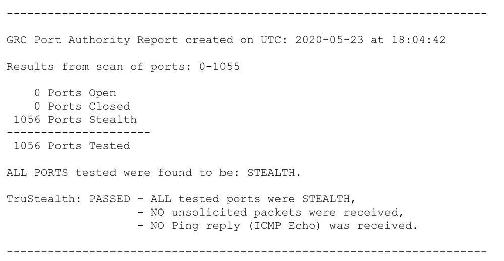

OK so I finally got some time to test this again now that v15.25 was released.
ISP modem only>RBR850 (with no devices attached accept for 1 wired Mac Book Pro 2018 OSX 10.14.6, No DMZ) and Firefox browser:
Seem the GRC is looking for ALL ports to be stealthed to get a PASSING result. The RBR850 is doing what it supposed to. I presume if other ports are seen as closed or open, then this means other devices and apps are connected to these ports. This reason why I wanted to try this again with just 1 wired PC running, no RBS, wifi devices or apps connected.

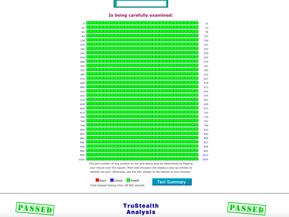

- tantrumMay 24, 2020Apprentice
I tried replying twice yesterday and my posts didn't get through - images again I suspect.
Bottom-line, the reason you are seeing the difference now is because of the 15.25 version has fixed the issue we were raising.
After updating that, I also get the ports showing stealthed properly now even with several devices connected.
It had *nothing* to do with you running an isolated test with just 1 wired device this time.

- FURRYe38May 24, 2020Guru - Experienced User
Well if there is a valid app or device accessing the port, then the port would be open at the time if GRC was being tested.
Here is my GRC results with everything conneted and working normally:
Well, seems like this new version of FW is helping or chaning what had been seeing in prior versions of FW. Users will be encouraged to update.
