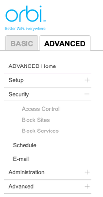

I have the MAC Address and IP address for the HomePod, is the some way to allow access or something similar? When I got to Advanced>Security>Access Control, "Access Control" is grayed out.

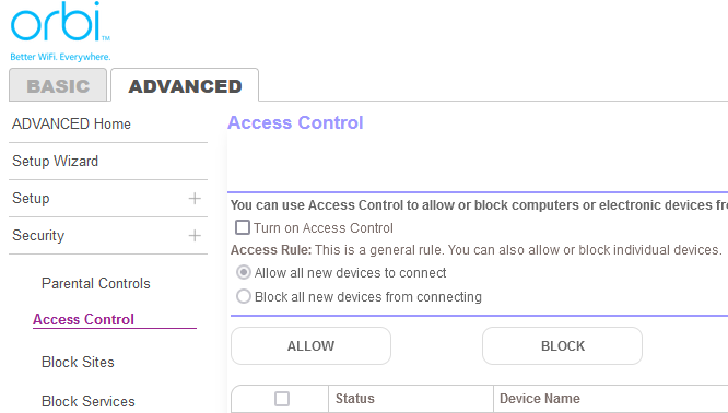

Could you post a screen shot of your Orbi showing what is 'greyed out'?
- DudeDahJan 04, 2023Aspirant
I'm thinking it is because I run my router in AP mode...
- CrimpOnJan 04, 2023Guru - Experienced User
(Shame on me for not asking) Access Point mode eliminates almost all the "Advanced" features.
