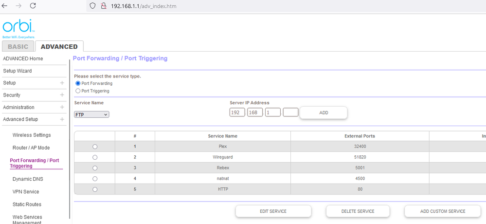

I have 2 NAS and found their TCP ports are in some cases not showing up in the UPNP table on this router.  Some do but others don't and oddly their seems  to be no logical reason.  NAS support says that is odd but no biggy just go into router an manually forward the ports to TCP.  Problem is when I go to the Port Forwarding/Triggering Orbi page and set it to port forwarding, TCP is not an option to set up.  I could set it up in a dozen other ways but not TCP.  NAS support says that is really strange and has not idea how to fix it but says none of the options seem to be correct for TCP.  AS step one in my quest to actually get my NASs to properly play with the Orbi router can someone explain how to either get its UPNP, which is on by the way, to recognize the NAS ports requests or how to forward these TCP ports?

    There are two types of network packets: TCP and UDP.  Different protocols use one or the other.  In addition, there is a number associated with each port.
    On the Orbi web interface, Advanced Tab, select the item on the bottom row: Add Custom Service.
    Notice the drop down menu where you select TCP, UDP, or both TCP/UDP
    Since you have two NAS units, this will be a bit tricky because any particular port must forward to one device on the LAN.
    What people often do is forward one external port to the expected port on one device and forward a different external port to the other device.
    Hope this helps.

      Sorry, I skipped over a step.  There are some ports that customers often want to forward, so the interface provides a drop down menu (upper left) for convenience.  This automatically fills in the parameters for that specific use.
      Access to a NAS is not on that drop down menu, so it has to be set up as a Custom Service.
      Also, access to two different devices requires use of two different external port number.

        Thanks, I had tried that before but when I clicked custom, nothing seemed to happen.  I had not waited long enough as I did it again based on your recommendation and about 15 seconds later it populated (yea).  A few follow ups so I don't screw this up.
