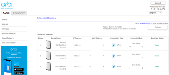

alternet wrote:all RBS are connected to RBR via cable (due to distance and tick walls).
Only RBS850 keeps in sync for longar then a day.
When I checked the status earlier today RBS350 were out of sync. Checking it now all are in sync

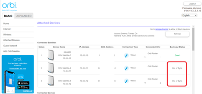

Here we go again:
Why is it happening that way? The RBS350 are Out of Sync most of the time!!! It seems like they are not compatible with the RBR!!! Getting crazy.
Mar 10, 2023Guru - Experienced User
Ya seems like there is problem with the 350s connecting to the 8 series system. You might leave them off for now until NG can review this and see what's going on.
I'd open up a support ticket:
https://my.netgear.com/support/contact.aspx
https://www.netgear.com/about/contact-us/
- Stra_qMar 14, 2023Aspirant
Hello,
Can you try disconnecting ethernet cable and connect wirelessly.
Make sure Router is on first. Give it a reboot if you will like. Wait 3-4 minutes. Then bring up one Satellite(closest one). Wait 5 minutes. Then bring up next satellite(Wait 5 minutes). Will like to see if out of sync will take much longer to happen. If does, there is a possibility of a memory issue with 350.
