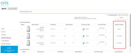

RBR850, RBS850, 2x RBS350 "Out of sync" & default "password"!!!
Hi all, I got RBR850 with RBS850 ....for a while everything worked well. After a while I had to add some more coverage to my system and got 2 additional satellites RBS350 (following compatibility...

No an idea where the problem is. Just please be also informed that the RBR does not recognize the RBS350 series properly (see the details):

One more thing (after restarting both RBS):
the admin password of RBS 2 (10.0.0.11) changed to the same as set on RBR - this is the RBS reported by RBR as Out of Sync!!!!
The admin password of RBS 3 (10.0.0.12) remains as the default (password)!!! - this is the one reported as Status GOOD by RBR!!!
As mentioned: the more I see the less I understand!!!!
