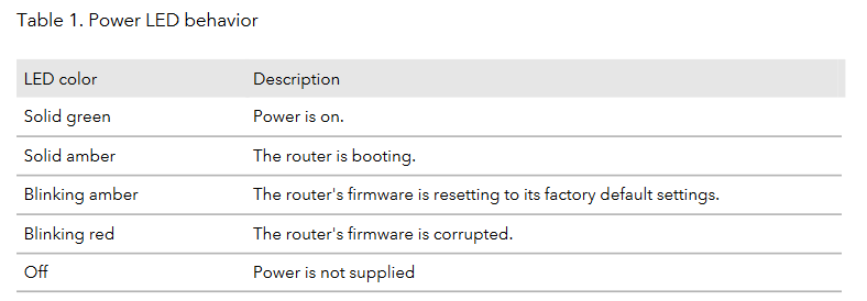

  • CrimpOn's avatar
    CrimpOn
    telabed wrote:
    The little orange DC light on the back of the router comes on but no LED lights in the front.
    The power LED is not supposed to be orange (amber). Page 10 of the User Guide
    https://www.downloads.netgear.com/files/GDC/RBK852/RBK852_UM_EN.pdf
    This tends to support the idea that the router is kaput. (not working correctly) If holding the reset button for a long time doesn't work, it's time for a replacement.
