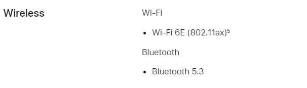

Well, it's your lucky day. 2023 MacBook Pro:
If connected over WiFi6E, the Macbook Pro would probably get higher speed from the 970 product than from the 850 product.
As to whether you will be astounded, "OMG. How fast this beast is now!!!" I have no idea.
