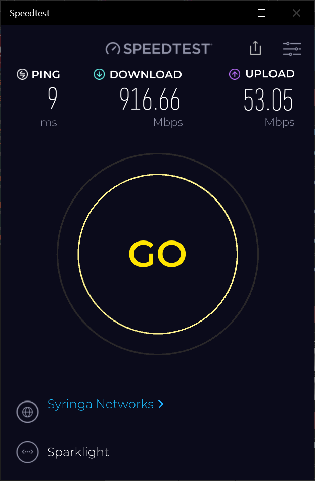

    Since the GS 3 series and RBR LAN ports are only max rate is 1Gb, you'll never see anything near 1400Mbps over ethernet thru this switch or thru the LAN ports on the RBR. You should see near 900Mpbs from the RBR though.

    What I get with my RBR ethernet connected:
