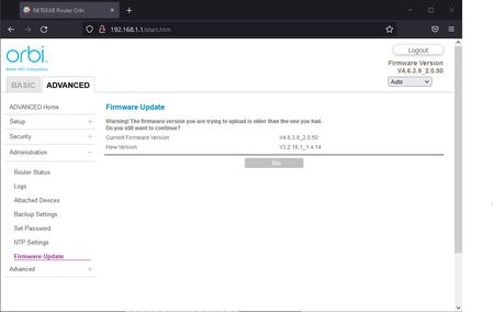

Trying to do a manual revert back to the previous 3.2.18.1_1.4.14 firmware but that gives a page with:
Firmware Update
Warning! The firmware version you are trying to upload is older than the one you had.
Do you still want to continue?
Current Firmware Version V4.6.3.9_2.0.50
New Version V3.2.18.1_1.4.14With only a "No" button
screenshot
Happens in several browser so unable to revert back :(
Anyone having the same problems?
