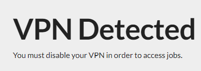

RBR850 VPN stopping traffic for Appen.com
Firmware Version V7.2.6.31_5.0.24 I have started doing some gig work for Appen.com and I am continually getting a warning: when I attempt to start a job. I get this also on my laptop, on ...

p.s. The VPN feature that Netgear includes in home routers allows the user to set up a VPN Host on the router so that users can access their home LAN when away by opening a VPN tunnel through the internet to their home router. That is not what the Appen software is complaining about.

Just trying to get these computers (W10, W11, Ubuntu) to Appen without the VPN warning.
The W11 (and Ubuntu) are fresh installs without any AV (Bitdefender, etc) or Anti-malware having been installed.'
On W11, just good ole Defender.
On Ubuntu, whatever comes native with it.
Still gives the VPN warning on the Appen job page...
Re CrimpOn - are you referring to BitDefender Armor on the PC? I can't find anything in ORBI's webpage relating to same under Basic or Advanced...
I have another question - When I connected the Ubuntu laptop directly to the modem, everything worked well.
However, when attempting the same with my W11Pro PC, It would NOT get an address from the modem. I tried (in Admin mode) the ipconfig /release, /flushdns, /renew.
Also > netsh int ip reset, netsh winsock reset.
The W11 just would not get an address from the modem; Ubuntu - no problem. Hence I could see that the VPN warning message is related to the NG Router.
