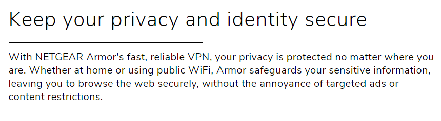

- CrimpOnSep 17, 2024Guru - Experienced User
Messages 6 and 7 appear to be inconsistent. i.e. the Orbi web interface says that Security is not enabled, but the Orbi 'app' says that it is enabled, correct?
My concern is that the description of Netgear Armor very clearly implies that it enables a VPN on the router to protect outgoing connections.
https://www.netgear.com/home/services/armor/
This is all very odd.
