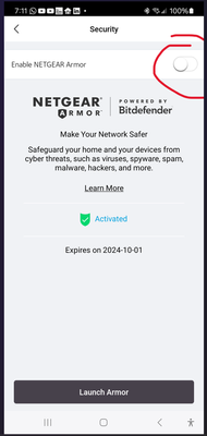

I just saw that NG Armor was enabled in the android app.
It is not.

Messages 6 and 7 appear to be inconsistent. i.e. the Orbi web interface says that Security is not enabled, but the Orbi 'app' says that it is enabled, correct?
My concern is that the description of Netgear Armor very clearly implies that it enables a VPN on the router to protect outgoing connections.

GM, I did mean to imply Armor was on, it is off on both interfaces:
