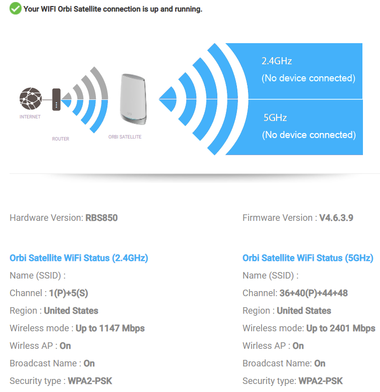

RBR850 in AP mode After updating to 4.6.3.9 (rbr850 and rbs850 s) lost CONNECTION (wireless) to my two satellites (RBS850). Tried wired (backbone), works. Switched to router mode all fine (wireless a...

As for the auto update, my rbr850 is on AP mode behind a pfsense router and I have blocked internet access to the rbr850

OK, got mine set up in AP mode (v4) behind a D-Link router with it's wifi radios disabled.
RBR set for a static .85 IP address.
RBS are both wireless connected and have a reserved IP address ON the D-Link router.
Manual channels 1 and 40. CTS 2347, 40Mhz only, Guest Network disabled.
Wired speeds thru RBR in AP mode to D-Link router to CAX80 modem:
I'll let this run for a couple of days and see how it goes...
