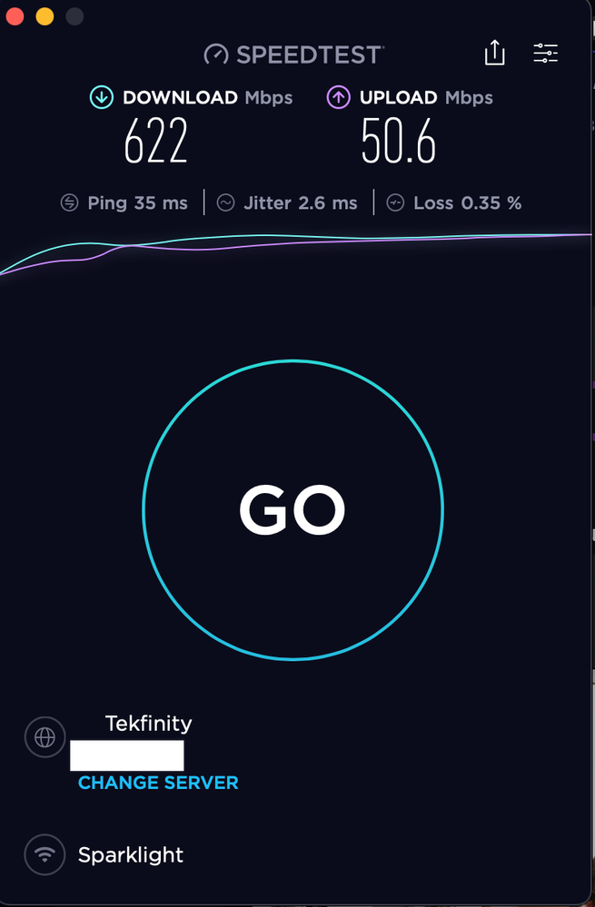

Speed testing with a wireless mac book pro connected to one of the RBS i'm near is pretty good too. RBR is set for 25% power output as well:
