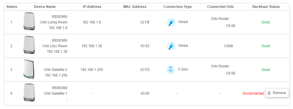

I've got my wired backhaul setup w/ two satellites plugged in via a 2.5G unmanaged switch (Trendnet TEG-S350).
I've got RBR960 w/ two RBSE960 satellites. Firmware V6.0.3.85_3.1.15.
The satellites show up double on the Attached Devices page of the webUI - one for wired and one for wireless. I think it's causing some connectivity issues. The wireless part connects and disconnects (possible due to the poor connection the wireless must have). Notice the MAC addresses are 2 apart between each satellite's wired and wireless connection.
Do I need to disable wireless backhaul somewhere? Is there some problem with connecting via an unmanaged switch in-between the router and satellites?

- NegatedVoidAspirantYeah, they've previously synced and worked fine. It also works fine with the satellites plugged in via the 1g ports, but obviously at reduced bandwidth
The switch is as pictured.
All the wiring is cat 6a and can hold a 10g connection fine with other equipment.- FURRYe38Guru - Experienced User
Each of the MAC addresses are different.
