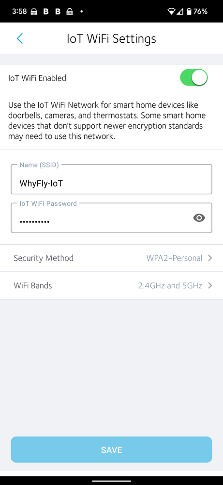

The SSID is "WhyFly-IoT" (it was automatically generated based on my usual network name it seems).
I've restarted the equipment, yes.
By "None of my devices", I mean both IoT devices and regular ones - my phone, my wife's phone, my chromebook, none of those see the IoT SSID either. All of these devices are connected to the regular "WhyFly" main SSID without issues.

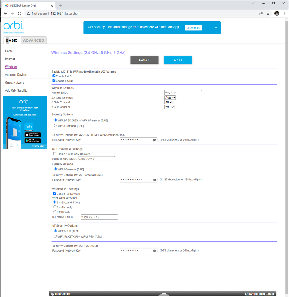

Verify that the "Enable IoT network" checkbox is checked on orbilogin.com's Advanced tab?
Let's also check some basic wireless info. On orbilogin.com's Wireless tab, what does Wireless Settings show? On my AXE system it says:
WIRELESS SETTINGS (GENERAL) Region North America 2.4 GHz Channel 1 2.4 GHz Wireless mode: Up to 400 Mbps 5 GHz Channel 36 + 40(P) + 44 + 48 5 GHz Wireless mode: Up to 2402 Mbps 6 GHz Channel 65 + 69(P) + 73 + 77 + 81 + 85 + 89 + 93 6 GHz Wireless mode: Up to 4804 Mbps - NegatedVoidMar 18, 2022Aspirant
Here are my settings, both in the app and the web interface - the structure looks a bit different than yours.
I'm going to try the factory reset option, i'll report back later today
