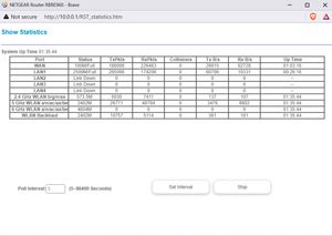

Does the CAX30 have a Show Statistics feature similar to the Orbi router? It might be interesting to observe how the CAX30 and the RBRE960 describe the Ethernet link between the two devices.
What happens when a different Ethernet cable is used to connect the CAX30 and RBRE960?
(It is sort of annoying that the User Manual does not describe advanced features, such as how to put the CAX30 into modem mode. There is no obvious benefit to having a Double NAT: Two routers: CAX30 and RBRE960.)

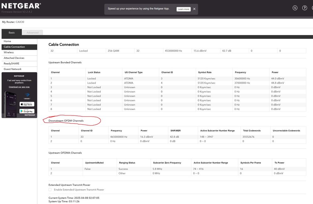

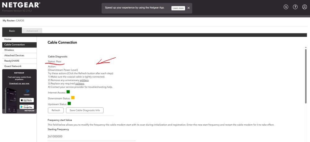

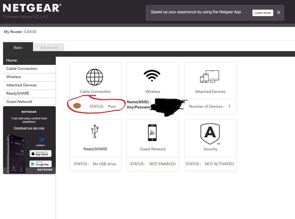

Let see the Event Logs from the CAX30 please: https://kb.netgear.com/30008/How-do-I-view-or-clear-the-event-logs-on-my-NETGEAR-cable-modem-or-modem-router
