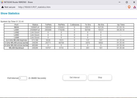

Does the CAX30 have a Show Statistics feature similar to the Orbi router? It might be interesting to observe how the CAX30 and the RBRE960 describe the Ethernet link between the two devices.
What happens when a different Ethernet cable is used to connect the CAX30 and RBRE960?

- Seattle206Apr 08, 2025Aspirant
- schumakuApr 08, 2025Guru - Experienced User
The poor downstream on the cable network is not the cause for the limited LAN connectivity which does work at 100 Mb/s only, leading to these 11.x MB/s data rates. The number is the very obvious indicator for a Fast Ethernet link in gte data path. Typical cause, leaving an issue alone, is very likely on the Layer 0, bad cable and/or bad connectors.

You've got multiple differnt things going on.
1. you're only connecting at 100mbps. Indicative of a bad cable/port. While the cable works cax30-->PC, some devices are more tolerant of sketchy cables. Routers tend not to be. Try a different cable and ensure its going directly cax30--->RBR and not through any wall outlets.
2. your power levels are to high for the modem. its why its saying poor connection. You should be between -7.5dbmv and 7.5dbmv. You're way above that. You can try putting an attenuator in the line to help with that or even a splitters (makes sure the other ends are capped off)
