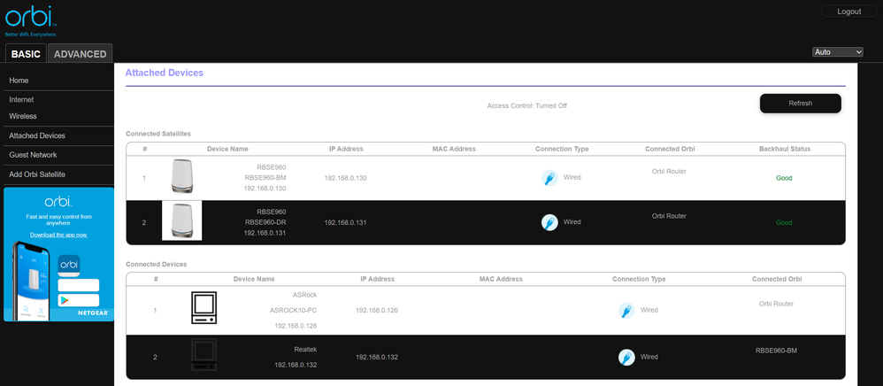

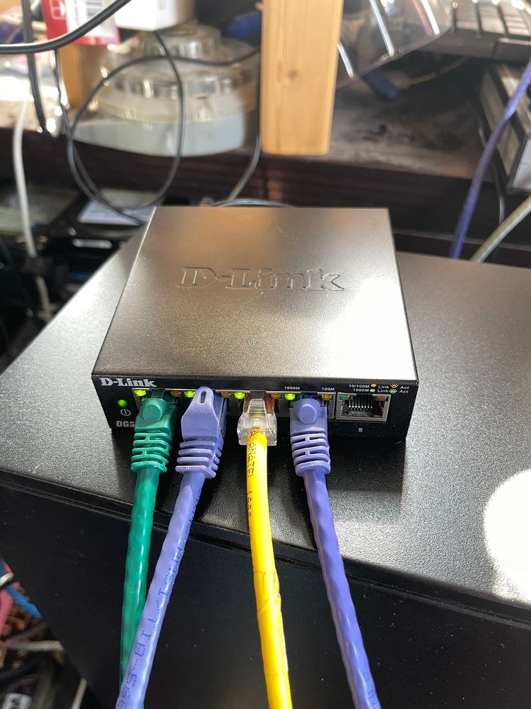

I put my 9 series online yesterday with a D-Link DGS-105 switch with the RBR and two RBS connected to it using only the 1GB ports on the RBS and RBR.
I first let the RBS wirelessly sync after powering them ON. Then after BLUE was seen on the RBS, I plugged in the RBS ethernet cables one at a time.
Green cable is feed from RBR. 1st Purple cable is connected to one RBS. Yellow cable is connected to 2nd RBS. 2nd Purple cable is a wired PC.
Saw no issues with the ports cycling or disconnecting in any way. I had a Mac Book Pro ethernet connected behind one RBS and speed testing thru the RBS was successful and to spec.
