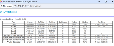

Close to 19 hours and the LAN port 1 where the NAS is connected to appears to be solid. I will move the NAS to port 4 and add back the Netgear 2.5 GB switch I am using for the wired satellite backhaul downstairs.
- FURRYe38Aug 21, 2024Guru - Experienced User
Awesome.

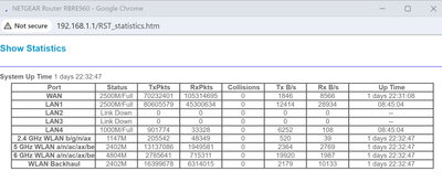

It has been a couple days and the LAN ports dropped while connected to my 2.5GB switch that is in a downstairs closet. Next step is to disconnect one of the backhaul LAN cables on the downstairs switch to see if having two satellites on the same switch is causing the problem.
- FURRYe38Aug 23, 2024Guru - Experienced User
K, Narrowing it down. Possible Switch or cabling issue...
