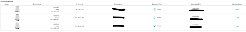

I have the RBRE960 with two satellites. One of the satellites I decided to use hardware for the backhaul connection. But now when I log into the router I see the hardwired connection as good and anot...

I have the RBRE960 with two satellites. One of the satellites I decided to use hardware for the backhaul connection. But now when I log into the router I see the hardwired connection as good and another 5G connection as good. The MAC address shows it is part of the wired satellite. The problem I am having is that 5G connection has a different IP than everything else. So things will connect to that IP and then I am not able to manage them. The only way I have seen to get around this is to assign a IP to each device. How do I get rid of that 5G connection?
- itguy97223Dec 12, 2022Aspirant
I have router and two satellites. One satellite is connected to the router via WiFi backhaul. With IP 192.168.25.200 The second satellite I have connected via Ethernet with IP 192.168.25.201. The second one is wired due to location and interference. The odd satellite with Wi-Fi has IP 192.168.1.250. If I change the second satellite to Wi-Fi backhaul it keeps IP 192.168.25.201. And the odd third one is no longer showing in Orbi router connected satellites. Things do not change if I use IE or Chrome to connect to the router.

Can you provide a screen capture if what your seeing. Edit out any MAC addresses before posting.

Home size is 2600sqft with distance from RBR to RBS around 27 ft. There is a lot of things in the walls and floor that cause poor connection to this RBS that is the reason it is wired. Wiring is all CAT 6. The CAT6 cable is connected to the 2.5gb port on RBS. The firmware I am running on both RBR and RBS's is 6.3.7.5. The odd RBS is the one labeled "where" when i check the firmware on that it says it is running 6.0.3.85 with service unreachable. I have comcast as my provider and I run a Arris Surfboard S33
