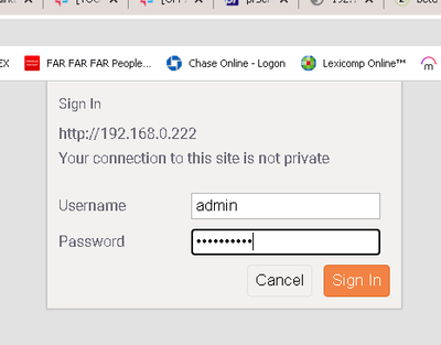

One lingering issue I can't login to the sats, although they appear to be connected and broadcasting. I used to be able to login to the sats via their reserved IP address. Wondering if I should try FR the sats?
As you instructed I setup the sats first via WiFi then switched to my wired backhaul, as I had before. But even tho the RBR reports sats are connected, and sats are broadcasting, I can't connect to their management webpage. I also noticed with this new firmware that the login prompt looks different on the sats, not sure if that is indicative of anything.
