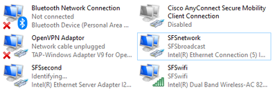

  3. The device does not appear on my network.  I have plugged it directly into the NIC on my PC.  I cannot ping it.  It’s booting, then starting again.
  4. My NIC tries to identify the RBS about every 2 minutes, because the RBS is in a boot loop, but it just keeps flashing white.

      My device will not get to a 'controllable' stage.  I have plugged it into the RBR and my PC NIC.
      It does  not 'boot' long enough to be viable.  It then cycles power and starts again.
