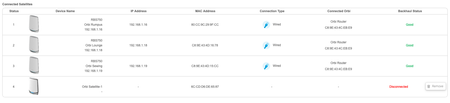

I have been through the wonderful community to try and get this working, I simply want to add another satellite. I believe that its firmware related, the RBR and 3 other RBS are all ok, this new ...

Appreciate the help, I have tried everything without success, I cannot get the laptop or a Mac to connect to either of the IP addresses. I have scanned the QR code but it will not join that wifi point either, or tried to connect to the RBS wifi from the laptop, no success.
I have even turned off off the RBR and the other RBS's so there is no confusion at all, its so frustrating I feel like dumping all the Orbi's as its just not user friendly compared to others I have used.
There has to be an easier way to get the firmware on this device.
