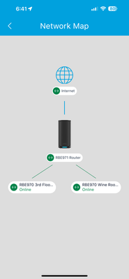

You will see, as in the picture below (note - the rest of the info is different - we have different Orbi models), a "Hop count" figure - if it's not 1, nothing can connect to it. If you see blank or 0, power cycle the RBS and see if you can then connect to it. If it's one, it's another issue.

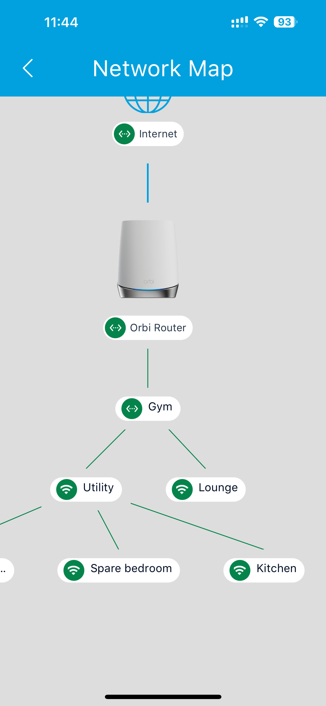

Interesting. I wonder what network topology your network has among the Orbis. If you have the Orbi app on an iOS or Android device, can you screen shot the Network Map diagram? On iOS, tap on "Satellites" in the blue on the main page. It looks something like this:
- PeterR69Aug 26, 2024Aspirant
Thanks Donawalt, half an hour ago the satellite (Gym in attached) was showing wireless, now it is showing wired
