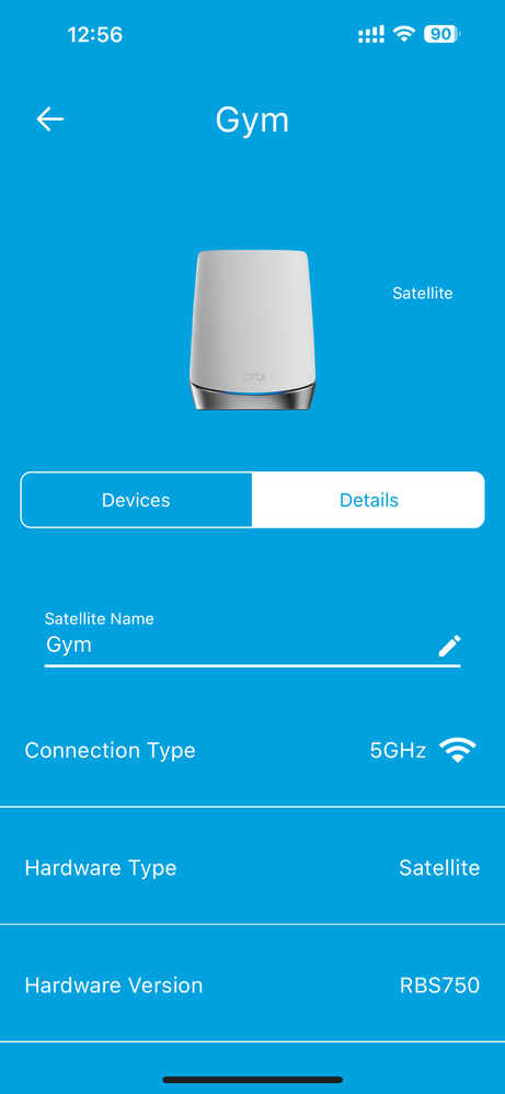

- PeterR69Aug 26, 2024Aspirant
Thanks Donawalt, half an hour ago the satellite (Gym in attached) was showing wireless, now it is showing wired
And now it is showing wireless. I've touched nothing ...
Satellite page on Orbi app
- donawaltAug 26, 2024Hero - Experienced User
Thanks - I see where a satellite could be showing hop count 3. For example "Spare bedroom" has to go 3 hops to get to the router.
