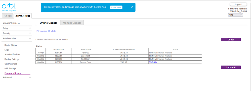

I can connect to the router web page and can see the RBR and two working satellites. All are at latest firmware version. Cannot see the faulty RBS. I tried direct ethernet connection between router and RBS but didn't help.
Now I tried another factory reset on the RBS
It flashed white for several minutes after the RBR went back to solid white.
During this time it did show up as a connected device - first hardwired (which it was not), then as a 2.4G connection. I checked the firmware and the faulty RBS was showing V.4.6.3.7 firmware so I pressed "Update all", but the satellite disconnected again. Now just showing a constant white ring.
