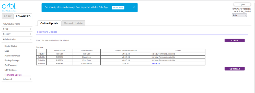

I can connect to the router web page and can see the RBR and two working satellites. All are at latest firmware version. Cannot see the faulty RBS. I tried direct ethernet connection between router and RBS but didn't help.

During this time it did show up as a connected device - first hardwired (which it was not), then as a 2.4G connection. I checked the firmware and the faulty RBS was showing V.4.6.3.7 firmware so I pressed "Update all", but the satellite disconnected again. Now just showing a constant white ring.

Can you get the RBS to connect again then see if it has a IP address next to it listed on the RBRs web page. If it does, you might beable to access the RBS web page using it's IP address, if you can, have the Same version of FW that the RBR is using and have this RBS FW file ready on your connnected PC. I'd wire connect the PC to the back of the RBS for a more direct connection. Send the FW file to the RBS direcly using the RBS web page.
Seems like the RBS FW is not using same version as RBR and other RBS. Possible the RBS update maybe corrupt as well.

Thanks for all your help on this, but how do I download a FW file to my laptop and then upload it to the RBS?
