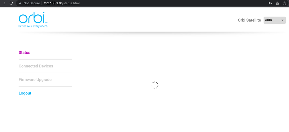

The ORBI mobile app shows it as "green" but no device connected to it. Again is this new one faulty as i login its admin page but always looping for status update?
Should i try to upgrade the firmware of all ORBI first? but if i cannot access the new one how can i upgrade its firmware?

Hello FURRYe38
i tried but failed to get the status of the satellite. Screenshots below.
- FURRYe38Mar 23, 2022Guru - Experienced User
Can you select the Firmware Upgrade section on the RBS web page at all?
- HoraceChanMar 23, 2022Aspirant
Hello FURRYe38 no i cannot
