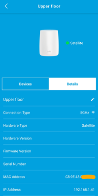

And the orbi app just showing some min. information on the satellite like below..
Weirdly, it seems like the satellite does sync with router, but I can't see anything on Attached device and the network is unstable...

        Second question:  When accessing the RBR, are you using the web-based GUI or the ORBI app? The picture you displayed of the ORBI app looks like it still believes you have your RBR50 running. (The app icon should show an RBR850 series with the silver base and sides.)
