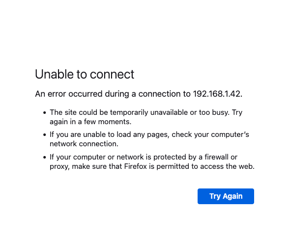

Regardless, I followed the instructions you provided because I figured there would be no harm in trying. I factory reset the satellite, disconnected my desktop from Wi-Fi, and directly connected the satellite to my desktop computer after manually setting the IP address to 192.168.10.49. It showed the ethernet port as "Connected" on my desktop. However, I could not get the satellite's web page at 192.168.10.250 through three different browsers. Browsers displayed "unable to connect" messages.

Did you try the default log in for the RBS at 192.168.1.42? If the RBS didn't sync but did get an IP address, default log in it should accept is the admin and password.
IF the RBS is getting an address from the RBR, just a matter of getting logged in right.

I tried connecting directly to the satellite after factory reset via both 192.168.10.250 and 192.168.1.250. Both connections timed out.

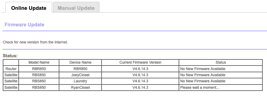

Then I tried a hardwire connection to the router and it is assigning the satellite an IP address. It has also retained the name of the device, started to display a firmware version (which it is saying is the same V4.6.14.3 as the other satellites), and even says the backhaul status is "good" - and seems to be staying that way for the past 30 minutes. The only thing that is different this time around is that the satellite is simply hardwired to the router, without ever having hit the "Sync" button on either device after the factory reset. While all of that is good news, it is still behaving quite strangely.
1) In the Firmware Update section, the status remains "Please wait a moment..." unlike the others
2) I remain unable to connect to the satellite's web interface. The other satellites work fine, but when I try to connect to the affected satellite, the below happens.3) None of the methods to reset the device and access any sort of web interface on the satellite work.
