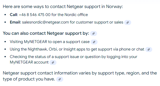

Bought it from a retailer, not sure Netgear has customer service in Norway.
