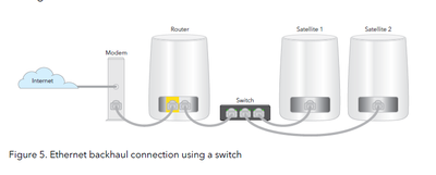

The Netgear documentation of the router says that I can connect router and satellite to the same switch for wired backhaul. This is what I am trying to do.
The switch is Dlink 1210-28. I will try direct connection just for testing, but there should be no need to remove the switch.
