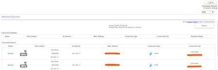

RBSE960 Satellites Listed As Connected Devices? Not Satellites.
After loss of power to the home, (2) satellites were disconnected, router was still broadcasting internet. After troubleshooting with power down and reset, white blinking LED resulting in +/- 90 se...

I have reset the satellites and this is when the satellites appeared on the devices list instead of satellite list.

Also lets try connecting the RBS using there 1Gb LAN ports to the back of the RBR using 1Gb LAN ports then go from there. First during the FR, let the RBS wirelessly sync to the RBR, once they are wirelessly synced, check the RBRs web page here first to see if they are shown as Connected Satellites. They should be here.
