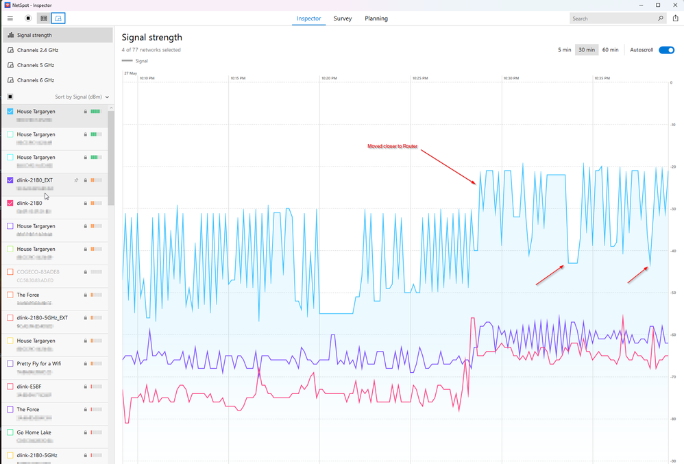

Out of curiosity, The spikes that I saw on the netspot signal graph... is this normal?- FURRYe38May 27, 2024Guru - Experienced User

Out of curiosity, The spikes that I saw on the netspot signal graph... is this normal?No, however maybe some interferences from the ISP gateway wifi causing some interferences. Can you test that again with just the RBR running?

Ok. My Orbi is on Channel 1, and 48. I have disabled both the 2.4 and 5 Ghz wifi on the Bell Router. Only the 6Ghz is left on. I have also disabled the Arlo Camera Basestation so that this 2.4 Ghz network was not in the mix. Also, which you can see on the image, I moved the PC antenna so it was more line of sight to the Orbi Router. (regardless, it was only 5 feet from the router) Now, it's only Orbi, the Bell 6Ghz, and the neighbors networks. I still see the WIFI constantly spiking between -20 and -40 dBm. The 20 dBm difference seems to be reflected in the measurements when the antenna was poorly positioned... so there is something going on.
Unless something else, my next move may be to try the .21 version.
