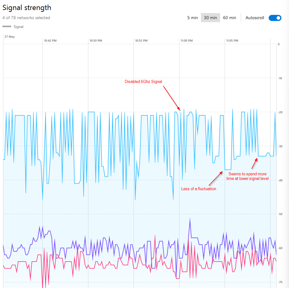

Out of curiosity, The spikes that I saw on the netspot signal graph... is this normal?

Out of curiosity, The spikes that I saw on the netspot signal graph... is this normal?No, however maybe some interferences from the ISP gateway wifi causing some interferences. Can you test that again with just the RBR running?

Ok. My Orbi is on Channel 1, and 48. I have disabled both the 2.4 and 5 Ghz wifi on the Bell Router. Only the 6Ghz is left on. I have also disabled the Arlo Camera Basestation so that this 2.4 Ghz network was not in the mix. Also, which you can see on the image, I moved the PC antenna so it was more line of sight to the Orbi Router. (regardless, it was only 5 feet from the router) Now, it's only Orbi, the Bell 6Ghz, and the neighbors networks. I still see the WIFI constantly spiking between -20 and -40 dBm. The 20 dBm difference seems to be reflected in the measurements when the antenna was poorly positioned... so there is something going on.

Am I able to lower the Router separately from the Satellites? Last time I tried reducing the power I pretty much lost all camera access completely (and I only choose 50%)Also, I just now disabled the 6Hz Wifi on the Bell router as well just to eliminate the possibility this is a factor. It did seem to have a small effect on the signal -- I am fluctuating now between -20 dBm and -32/-37 dBm... regardless, still experiencing cameras dropping and streaming dropping, so although it improved it, it didn't resolve it 😑
Interesting though that the 6Ghz signal caused interference with the 2.4 Ghz signal.
