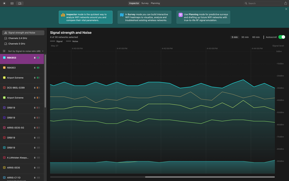

Ok. My Orbi is on Channel 1, and 48. I have disabled both the 2.4 and 5 Ghz wifi on the Bell Router. Only the 6Ghz is left on. I have also disabled the Arlo Camera Basestation so that this 2.4 Ghz network was not in the mix. Also, which you can see on the image, I moved the PC antenna so it was more line of sight to the Orbi Router. (regardless, it was only 5 feet from the router) Now, it's only Orbi, the Bell 6Ghz, and the neighbors networks. I still see the WIFI constantly spiking between -20 and -40 dBm. The 20 dBm difference seems to be reflected in the measurements when the antenna was poorly positioned... so there is something going on.

Am I able to lower the Router separately from the Satellites? Last time I tried reducing the power I pretty much lost all camera access completely (and I only choose 50%)Also, I just now disabled the 6Hz Wifi on the Bell router as well just to eliminate the possibility this is a factor. It did seem to have a small effect on the signal -- I am fluctuating now between -20 dBm and -32/-37 dBm... regardless, still experiencing cameras dropping and streaming dropping, so although it improved it, it didn't resolve it 😑
Interesting though that the 6Ghz signal caused interference with the 2.4 Ghz signal.

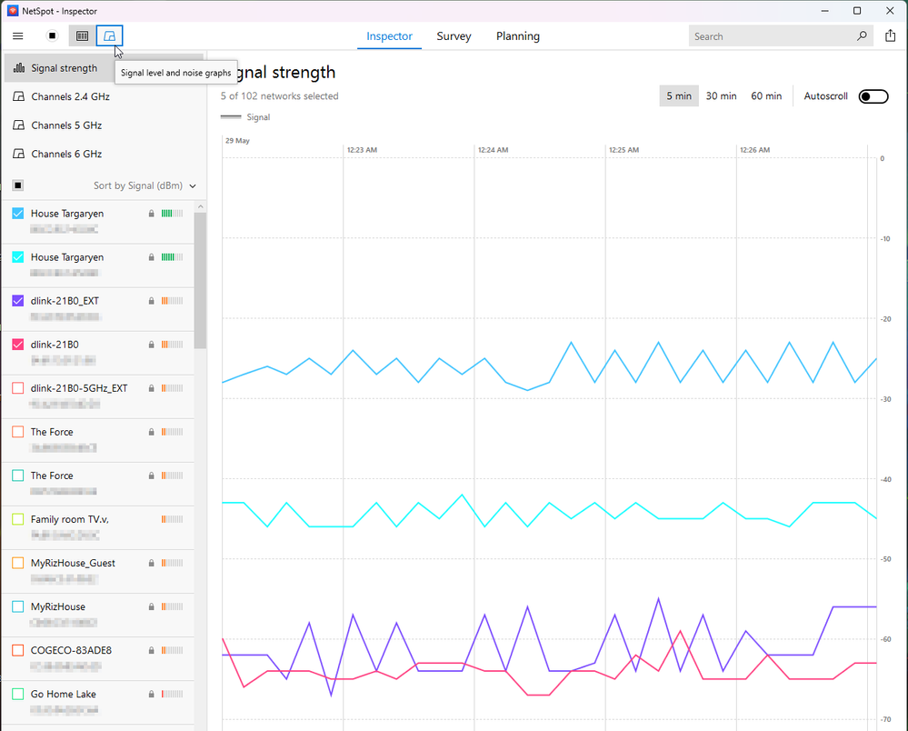

So is yours taken with just the RBR alone and the RBS turned OFF as well along with ALL wifi disabled on the ISP router?
I put my 850 online yesterday and took this from just the RBR alone:- RedlowMay 28, 2024Aspirant

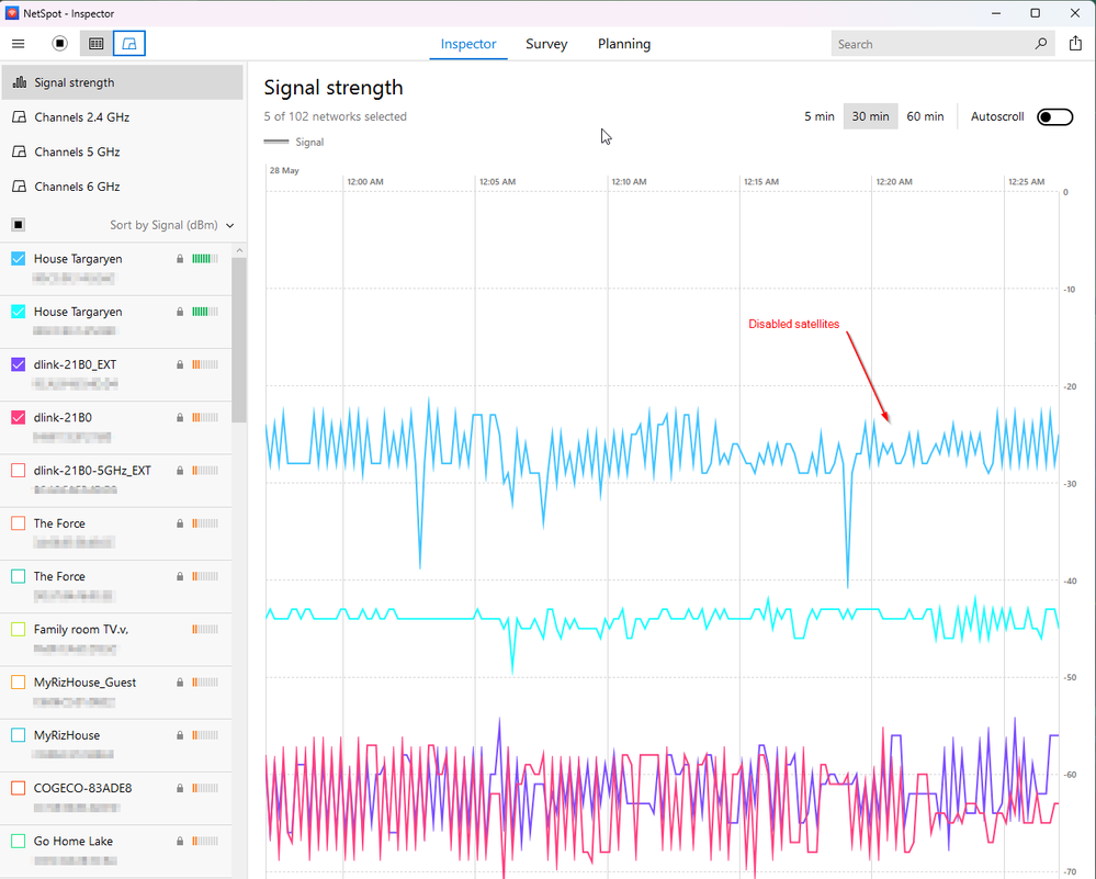

Hi FURRYe38 . I had tried just the RBR alone in the past, and it had made my home network unusable -- the cameras wouldn't connect at all. However, I just now disabled the satellites, and the signal has definitely improved compared to the last scan (see graphs). It isn't spiking to the low 40's, but it is still not as smooth as your results - yours have very little variance within the second, unlike mine which varies a lot within the second. That being said, my google cameras are working...
