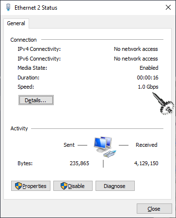

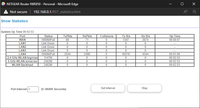

      • FURRYe38's avatar
        Try this, disconnect the RBR from the modem.
        Factory reset the RBR and let the front LED blink WHITE.
        Pull the power cable from behind the RBR for 30 seconds then plug back IN.
        Setup from scratch with out it connected to the modem.
        When you get to the home screen, connect 1 wired PC to the WAN port of the RBR. Open the networking adapter status window on  this PC and check the connection speed seen here. The PC wont get an IP address however we are looking to see if the PCs adapter can see the connect rate on the WAN port. 1000Mpbs should be seen here I hope.
        Also check the Show Statistics section on the RBR web page. This will show all connection rates of connected devices on the WAN and LAN ports.
