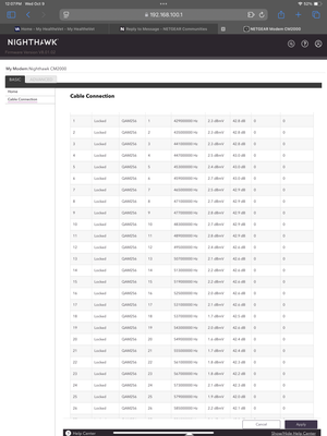

Modem info:

Other modem logs look good. No issues there.
