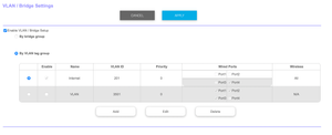

I was able to plug my laptop directly into the wall and everything worked fine. I did a reset and now I get a Self Assigned IP every time I plug my laptop to any jack on the wall. I just did a router reset and don't know why this is happening. Can anyone help? These are my VLAN settings below:

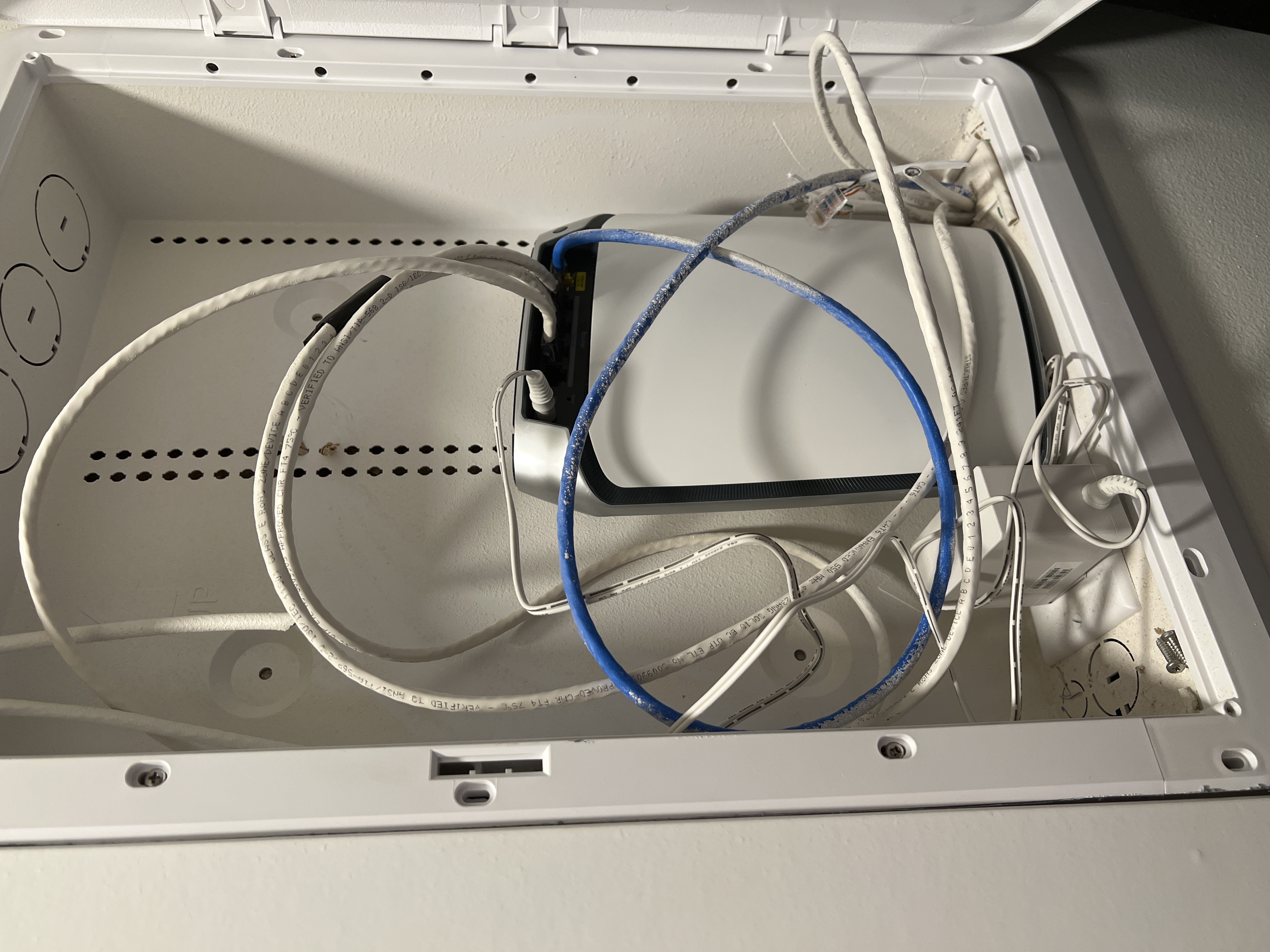

- christoepherrApr 01, 2022TutorI basically followed the steps here to get rid of the CenturyLink modem/router
https://www.reddit.com/r/centurylink/comments/ic4asm/howto_you_may_not_need_that_c4000xg_or_whatever/
Hopefully the picture I attached helps. I got rid of the CenturyLink modem because it was huge and I couldn’t close the patch panel by using it.
And these steps worked. I was able to plug my laptop directly to the jacks in my wall, but after I did a reset they no longer work.
