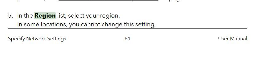

It is very smart to get an answer from "someone who actually knows" to this question. My ancient RBR50 Orbi has this comment in the user manual:
I am in North America, and sure enough, I cannot change the Region Code. Maybe I cannot change it because I am in North America, or maybe there is some "other reason".
Netgear has forum moderators who manage different parts of the globe. Perhaps there is one responsible for customers from India (but I have no idea how to find out if that is so or how to reach such a person).
