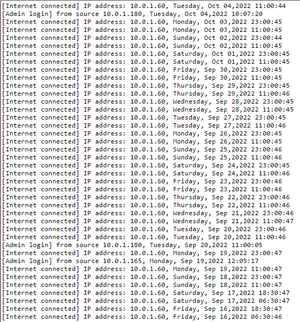

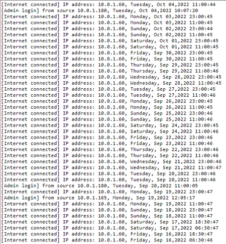

Hello everyone, I have an Orbi RBR 850 router and 4 RBS850 satellites. On the router it is version V4.6.9.11 and on satellites version V4.6.8.5. I don't understand what the problem would be with them...

robertosimion89 wrote:
Hello everyone, I have an Orbi RBR 850 router and 4 RBS850 satellites. On the router it is version V4.6.9.11 and on satellites version V4.6.8.5. I don't understand what the problem would be with them because in the logs it tells me that the internet is always connected at the same time.
Can someone help me?
The RBS FW needs to be one same version of FW as the RBR.
Your ISP Modem already has a built in router and wifi. This would be a double NAT (two router) condition which isn't recommended. https://kb.netgear.com/30186/What-is-Double-NAT
https://kb.netgear.com/30187/How-to-fix-issues-with-Double-NAT
Couple of options,
1. Configure the modem for transparent bridge or modem only mode. Then use the Orbi router in router mode. You'll need to contact the ISP for help and information in regards to the modem being bridged correctly.
2. If you can't bridge the modem, disable ALL wifi radios on the modem, configure the modems DMZ/ExposedHost or IP Pass-Through for the IP address the Orbi router gets from the modem. Then you can use the Orbi router in Router mode.
3. Or disable all wifi radios on the modem and connect the Orbi router to the modem, configure AP mode on the Orbi router. https://kb.netgear.com/31218/How-do-I-configure-my-Orbi-router-to-act-as-an-access-point and https://www.youtube.com/watch?v=H7LOcJ8GdDo&app=desktop
