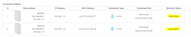

- Rob6805Nov 20, 2022Tutor
I may have found the root of my problem. BOTH of my RBS350 satellites go out of sync periodically. I have reset them multiple times and always get a solid blue light. But...eventually they go out of sync after a period of time (and I am not moving them).
I am really not understanding why this isn't working. The system is less than a month old and I now I am thinking that it has never worked correctly.
This is maddening.
They flip flow going out of sync. Both the satellites are within 20' of the router. And I did reset the router. When I do, both satellites connect and show good sync status. Then a few minutes later they start going in and out.
- CrimpOnNov 20, 2022Guru - Experienced User
"Reset" or "Factory Reset"? I ask because one of the common recommendations when WiFi systems behave strangely is to "clear it all out and start over." (Actually, that advice goes back to 1982 and the IBM PC.) If you haven't, someone will suggest it.
This may be a good time to start another conversation with a new title. I am concerned that people will see "Reolink camera" in the title and think, "I don't know anything about whatever Reolink is", and not bother to open the post. For now, it appears that the issue is "RBS350 satellites lose sync with <which router, RBR350? RBR750?>" I have no 350 products, and thus have no practical experience with them.
