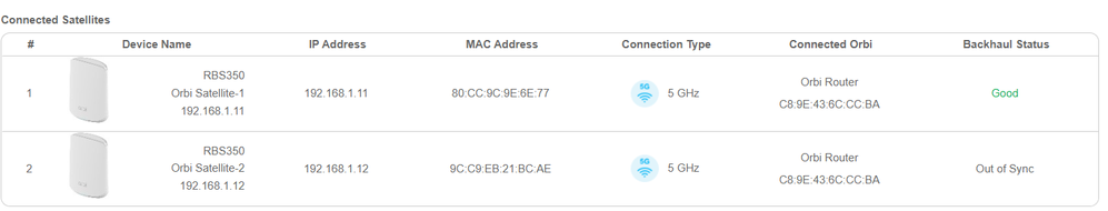

They flip flow going out of sync. Both the satellites are within 20' of the router. And I did reset the router. When I do, both satellites connect and show good sync status. Then a few minutes later they start going in and out.

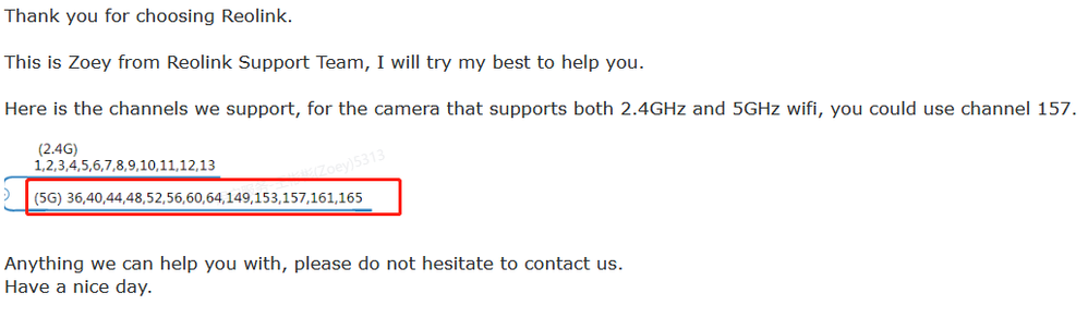

Just to wrap up one aspect of this situation. I contacted Reolink support and asked, "what WiFi channels do the cameras support?"
And this is their answer:
So, the issue is not channel 157. It is the satellite losing connection with the router, which results in the camera having no network connection.
Did we resolve whether the system has been Reset, or Factory Reset?
- Rob6805Nov 21, 2022TutorYes, I too contacted Reolink support and got the same answer. Ch157 is supported. I am going to contact Netgear support this morning and see if they can help.
