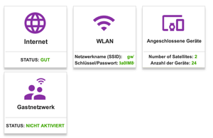

RGR850 shows empty device and satellite list...
Hi, i have a RBK853 system installed in my home running in AP mode...behind a web-router from my ISP(3 webgate). On the RBR there is also a lan cable connecting my wired computers. Firmwareversion o...

Ok.. so i have now connected my network as it was before i had my ORBI RBK853 system...
The ISP modem(placed on 2nd floor) is connected to the cable which goes to the wired network (switch). ISP modems WLAN and DHCP is off.
DHCP is running in the wired network on a mac because of IP reservations for some special WLAN devices...i cant do this in the IPS modem.
The RBR is now connected to a switch in the wired network on 1st floor...same place where my old AP was connected...
All is now working as ist should... and i am now free to place my RBR where it best fits...
Tomorrow i will position and sync my 2 satellits ... one on the 2nd floor and one on the ground floor...
Hopefully it works this way in the end...

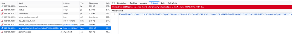

Maybe i have seen something in the firefox network inspector... there is an error in the answer... see picture...
But why is this?
- FURRYe38Jul 07, 2021Guru - Experienced User
Please select the Choose File button on the forum post and attached the picture file that way. We can't see inline pictures until a moderator approves them.
