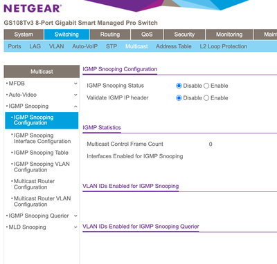

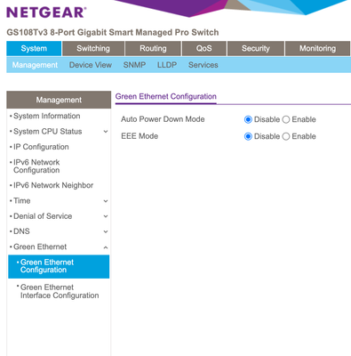

Ya you might reset that switch then just disable IGMP protocols and any Green ethernet features. Might work to help check the switch. If you can't get the switch working, try one that was suggested. Tried and tested with mine.
- ferozarSep 21, 2022Guide
Currently, I have it like this:
- Disable EEE options.- Disable IGMP options.
are there any other options?
