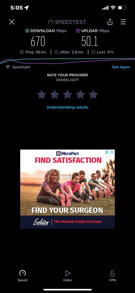

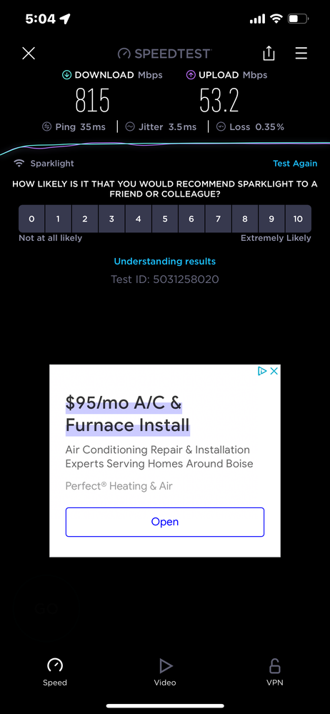

Just did a test with my iPhone 12 Pro Max.
4 feet:
25 feet:
