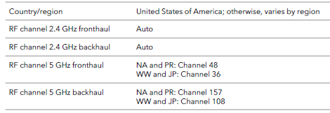

      The WiFi channel used for backhaul varies by country:
      In some parts of the world, Channel 108 requires the Orbi to implement DFS/TPC (see footnote 6 in)
      https://en.wikipedia.org/wiki/List_of_WLAN_channels#5_GHz_(802.11a/h/n/ac/ax)

      • Region= North America - United States
        Is there a way to see what channel is used for the back-haul?  I can't seem to find it on the router's web page.
