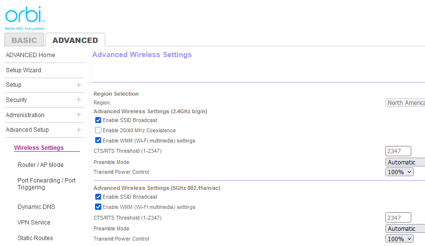

How do i ‘turn down the power’ on one of the satellites?
- CrimpOnOct 29, 2024Guru - Experienced User
AlexHobson wrote:
How do i ‘turn down the power’ on one of the satellites?This is not possible. The Orbi web interface, Advanced Tab, Advanced Settings has an entry for Wireless Settings.
This allows the Transmit Power for the 2.4G and 5G WiFi channels to be adjusted from 100% down to 25%.
Changing this setting affects every Orbi unit. (The Backhaul WiFi power cannot be managed by the user.)
