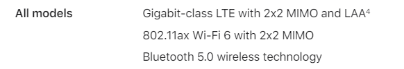

    Assuming "in the same room" means within 6-8 ft. of the Orbi router, these results appear lower than expected.  The iPhone 11 is capable of WiFi6:
    (2x2 MIMO means the iPhone has two antennas)  This leads to a theoretical "Link Rate" of about 1.2Gbps.  It is common for WiFi devices to achieve about half the Link Rate in actual transmission.  Thus, one would expect with a Gigabit internet connection that the iPhone would achieve over 400Mbps in Ookla Speed Test.  (My ancient WiFi5 Android phone measures over 350Mbps when connected to my 2016 WiFi5 Orbi RBR50. This is with an ISP connection of about 350Mbps.)
